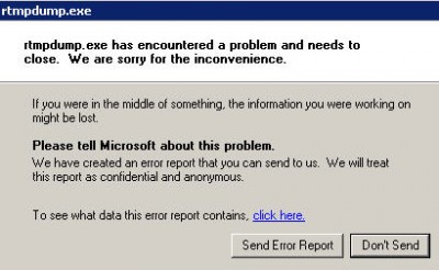

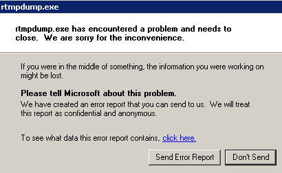

#443924
Nope, back to square one again. "rtmpdump.exe has encountered a problem and needs to close". And getiplayer is now retrying recording over and over again (probably endlessly, although now it's trying to record it to wma). So I can't run PVR Manager at all, and GetiPlayer eventually has the rtmpdump error. And this is trying with Neil's folder, and with my folder.
Starting to look like someone else might have to start downloading/editing/uploading the current Moyles shows at this rate. The only other option for me is to record a 3.5hr show in real time, but I can't do that every day.
#443925
I would suggest nuking your install from orbit with Revo uninstaller or similar, then delete the whole get_iplayer folder, run all Windows updates, install the normal get_iplayer install again and copy my folder over. I had problems on one of my PCs with it not working, and using my folder from the other machine worked.
